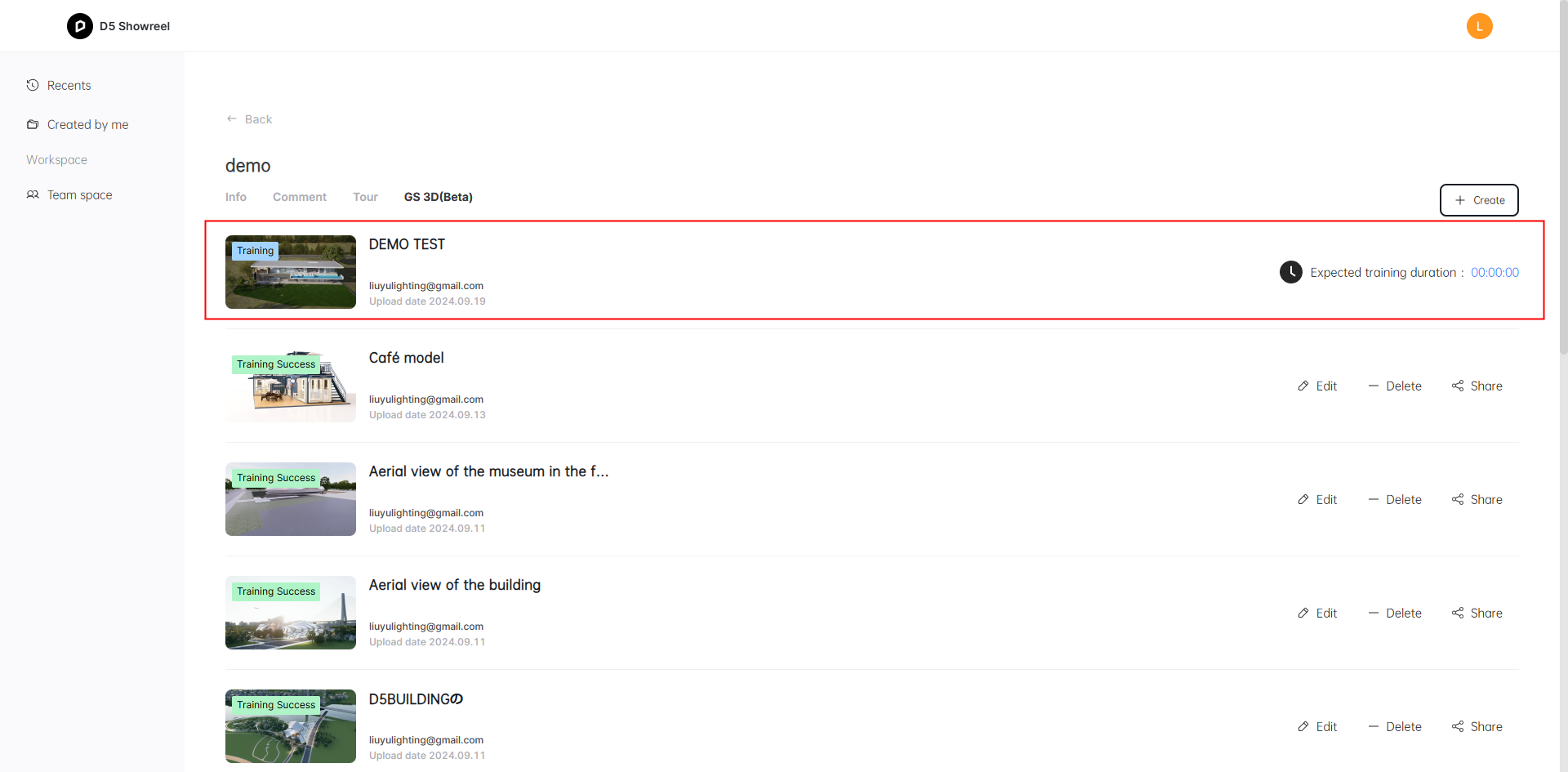

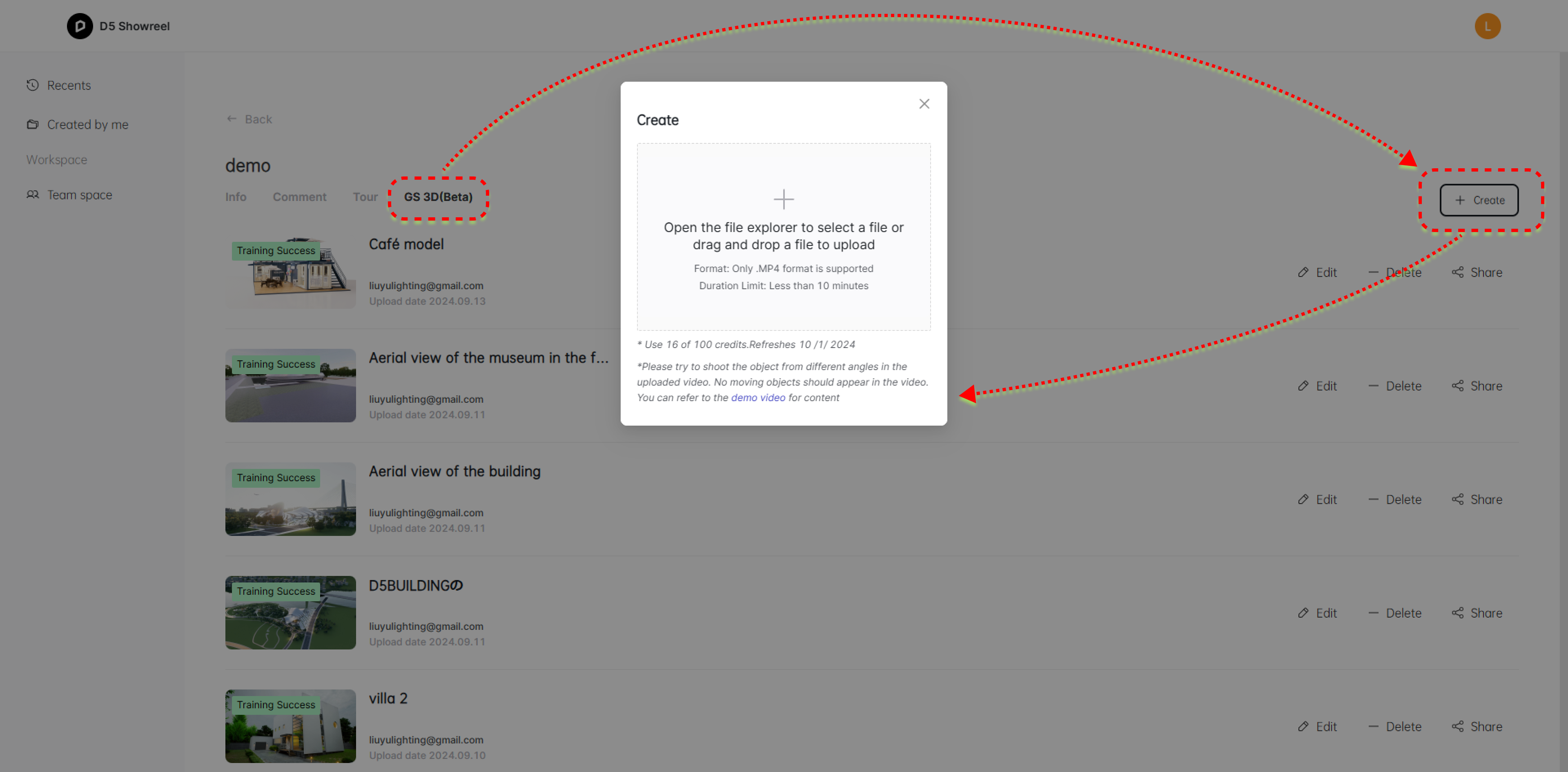

Begin by uploading a one-shot video of the object you want to convert into a 3D model. This could be a video rendered in D5 Render or footage captured on your smartphone. The Video to 3D service in D5 GS processes the footage, converting it into a real-time, fully interactive model.

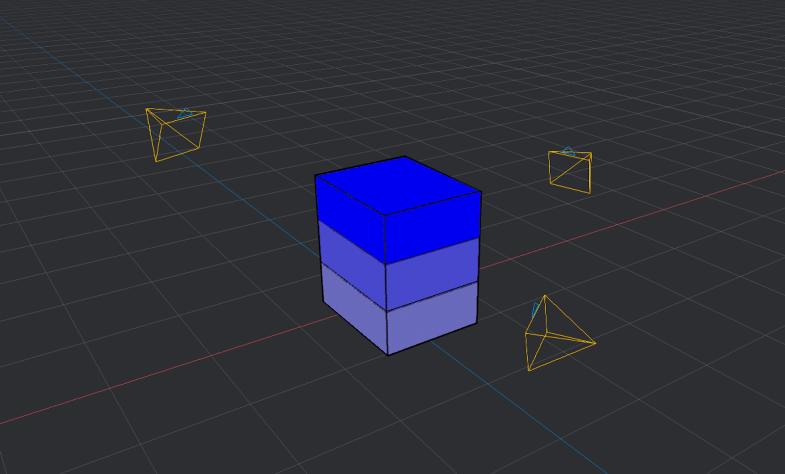

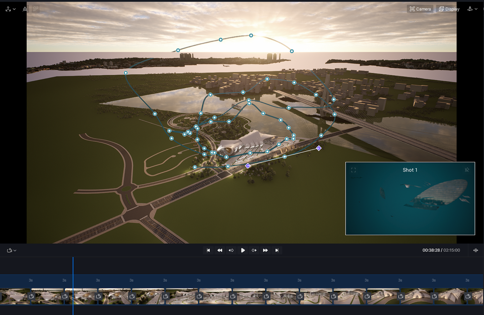

3.1 Capture Multiple Angles:
For better quality, record your object from a variety of angles. Use a circular, ascending approach that captures top, middle, and bottom sections for a full 360-degree view.

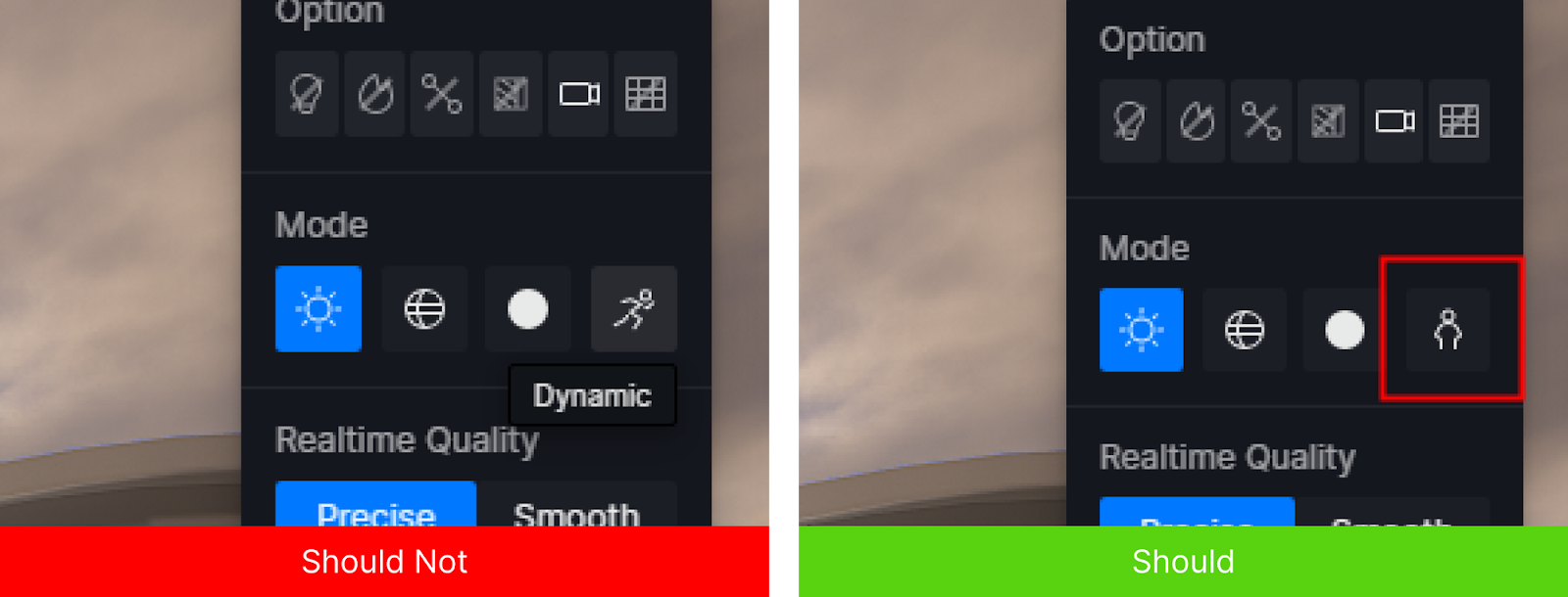

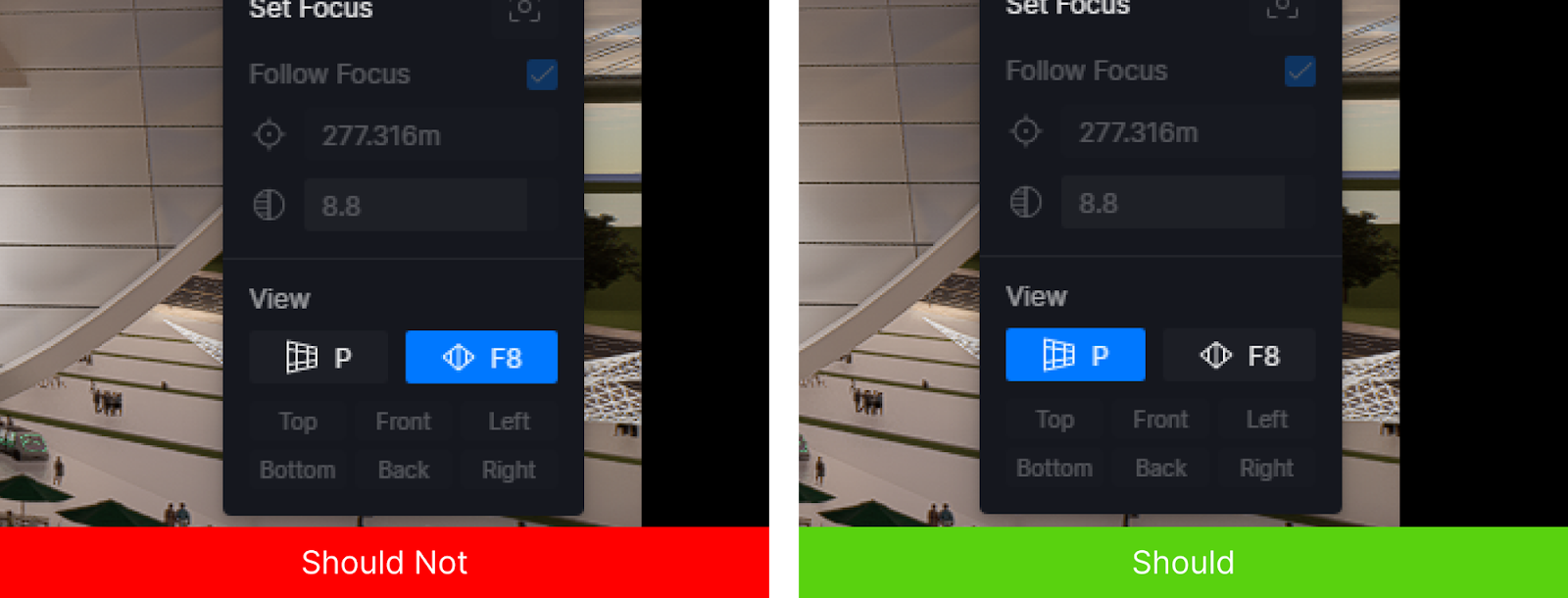

3.2 Avoid Dynamic Objects:
To maintain model accuracy, avoid moving subjects in the frame. Also, disable any dynamic effects and the 2-point perspective in D5 Render to prevent distortion.

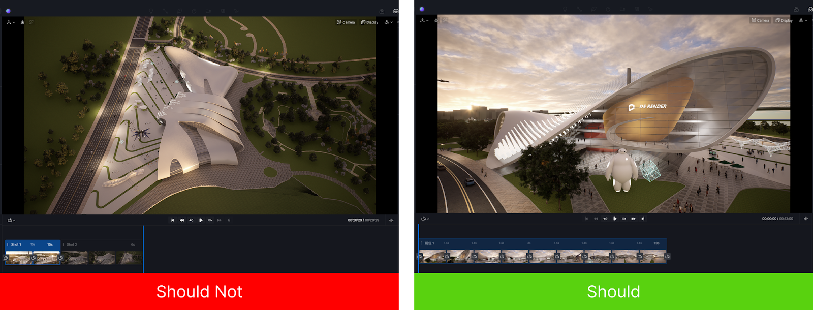

3.3 Use a Continuous Shot:
Ensure the video is a single, continuous shot without cuts. The service only processes the initial segment, so multiple cuts may prevent full rendering.

3.4 Keep Camera Movement Smooth:
Smooth camera movement is crucial. Sudden position changes can lower the model’s clarity, as D5 GS samples four frames per second during training.

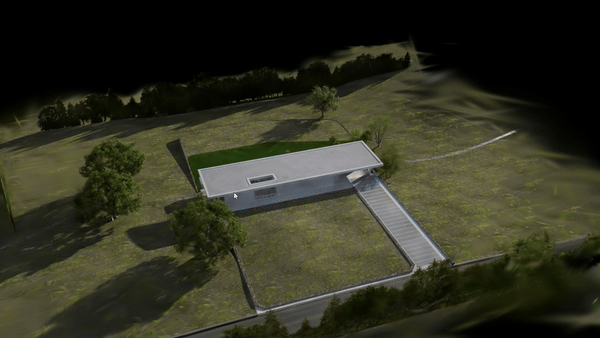

4.1 Elevate Architectural Visualizations
gaussian splatting

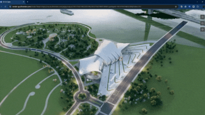

Convert your architectural projects into interactive 3D files that clients can explore online. Unlike traditional panoramic VR, which is ideal for indoor and ground-level views, Aclarado Gaussiano 3D is perfect for creating bird’s-eye views of buildings, offering a unique perspective for clients.
See an example of a bird’s-eye view here.

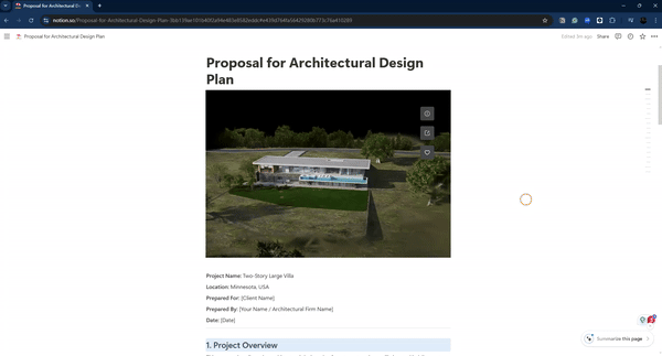

4.2 Collaborate in 3D with Online Tools
Cómo usar Gaussian Splatting para convertir videos MP4 en modelos 3D
Seamlessly integrate 3D visualizations into online platforms like Notion o Google Docs, enabling synchronized 3D project collaboration within your team. Imagine presenting a 3D model as part of a proposal, where clients can explore the design directly in their web browser!
