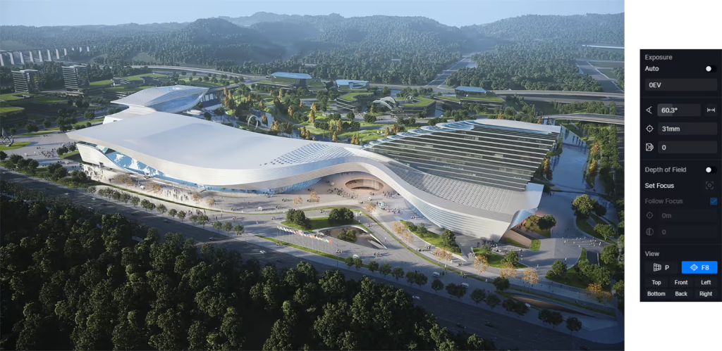

– The aerial view: It refers to the view of a building taken from the air. The corresponding camera height depends on the volume of the building you need to show. Generally speaking, the higher the camera, the more surroundings will appear in the sight.

Aerial view | Rendered with D5 Render

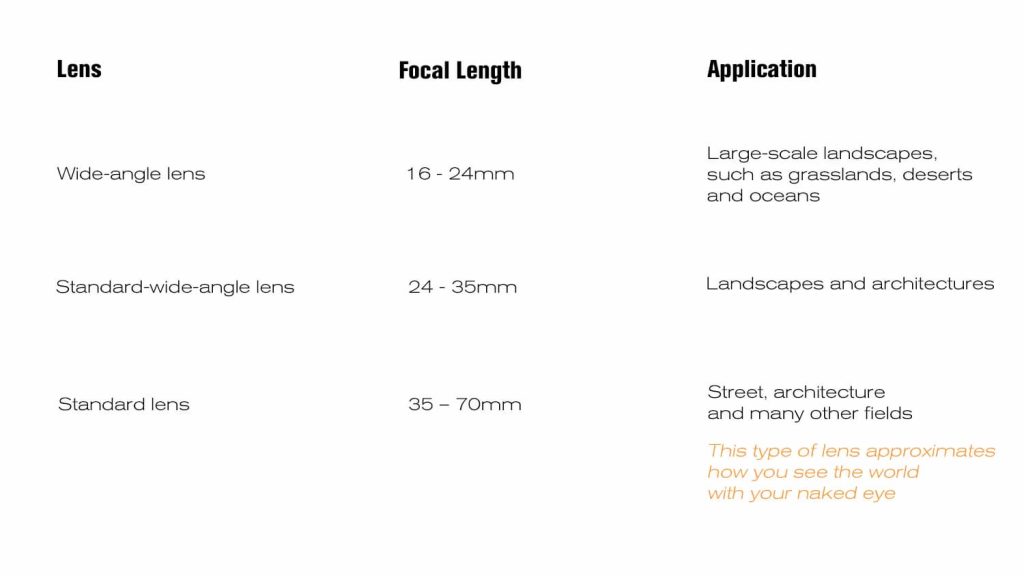

They are both interrelated, and closely relevant to lens in the real world.FOV is directly determined by the Focal Length. The larger the Focal Length, the farther you can see, but the smaller the FOV.
Think about the telephoto lens and the wide-angle lens. The former has a long focal length and a small field of view, while the later is opposite. So, when you change one of the parameter, don’t forget the other one.
Here’s a table that can help you understand the relationship between the FOV and the focal length.

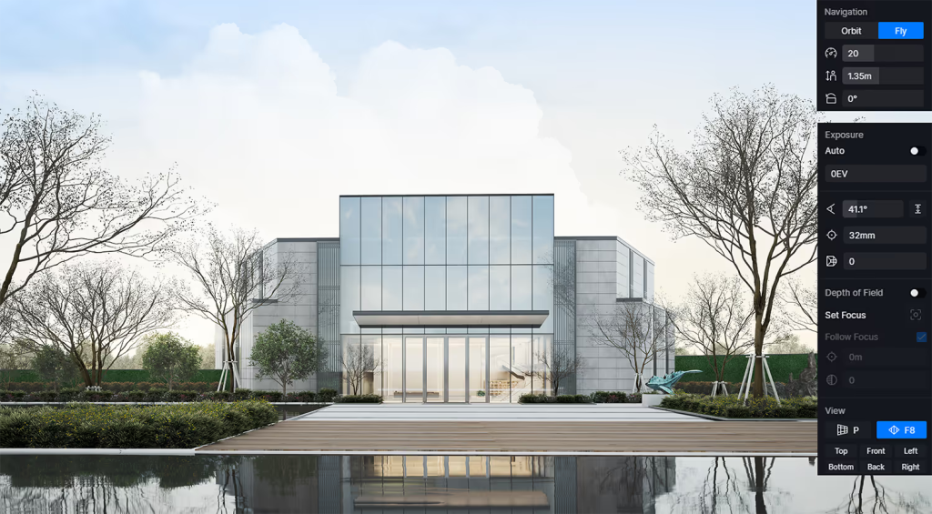

Take this scene created with D5 Render for example.
Camera Setting Tips Must Known for Archviz
Reproduction rendering of the architecture | Rendered with D5 Render
Photography of the architecture | Rendered with D5 Render
