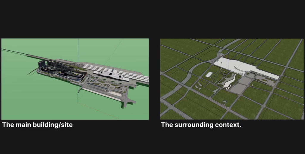

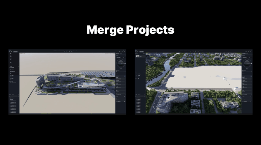

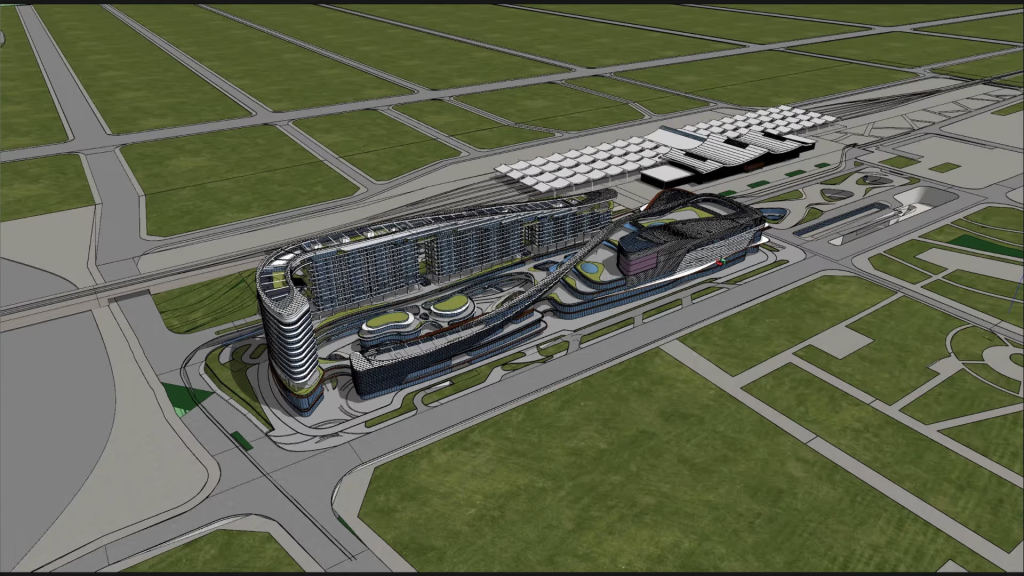

Take this SketchUp project as an example.
You can divide the project into two parts including the main site and the surrounding context.

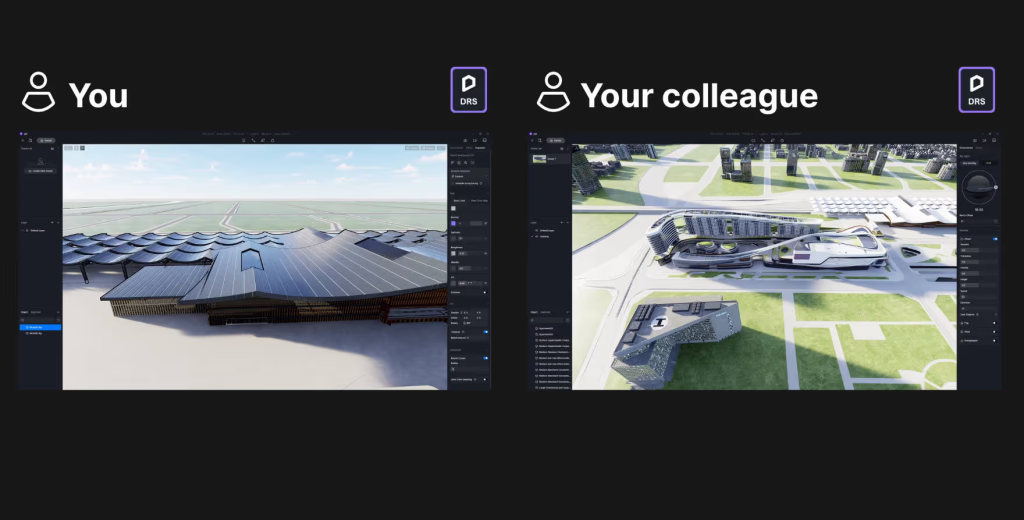

After importing to D5 Render, separate them as two scene files. Then you and your colleague can dive into the visualization of two parts at the same time.

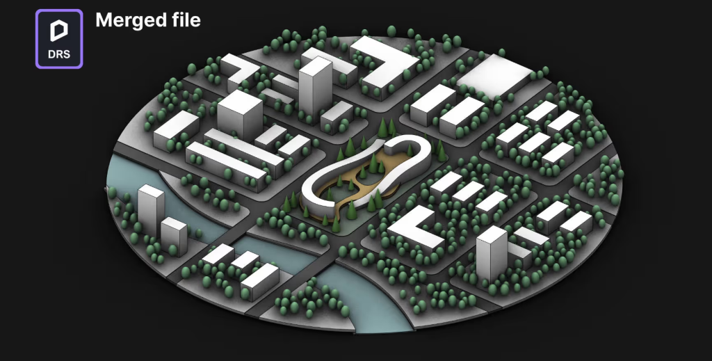

When completing the two parts, you can merge them into one.

After importing the divided models into D5 Render, save the scene file and create as many copies as your team needs. Then, you and your colleagues can simultaneously work on different scene files. Remember to delete irrelevant parts of each scene file and save them.

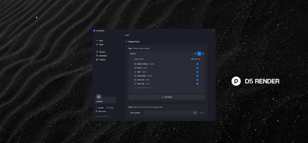

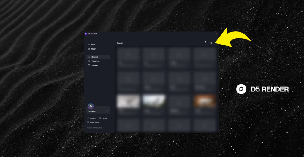

Go to the D5 welcome page > Recent and click the icon in the upper right corner.

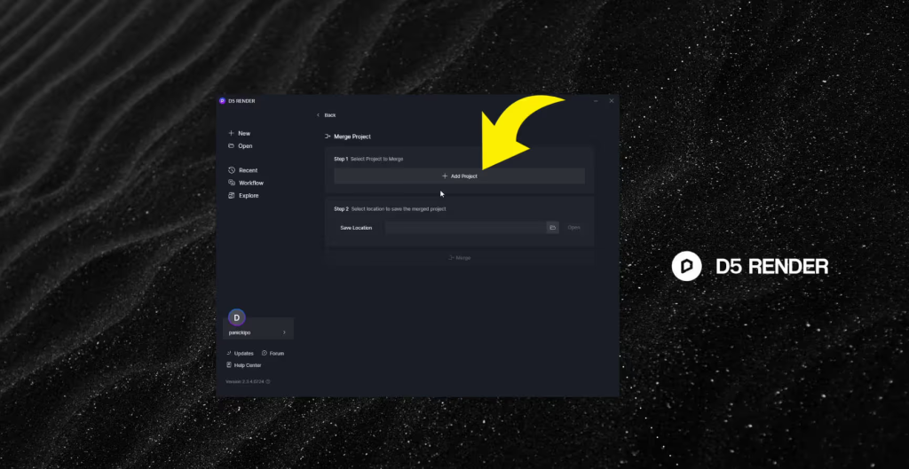

Add the projects you need to merge.
Here you will see that D5 Render can merge imported models, nature models, light sources, and other D5 assets, scene lists, video clips, and render queues.
You can merge all or some of them.
Finally, choose the file path where you want to save the project and start merging.

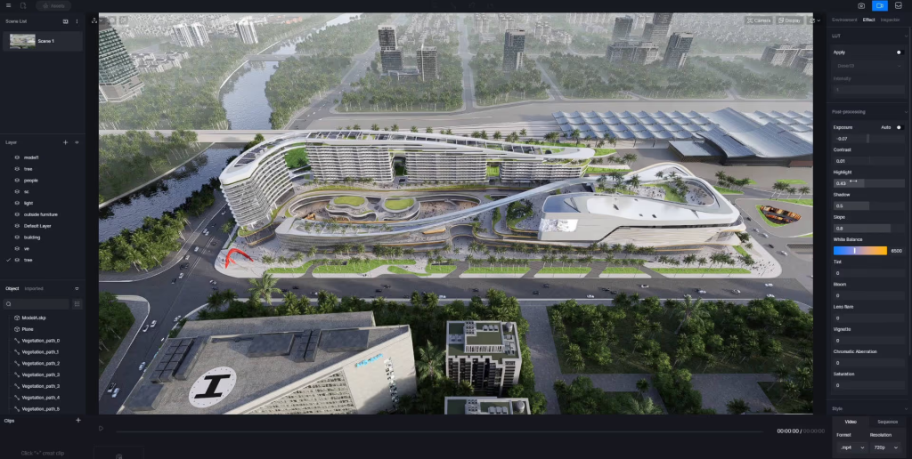

Now, you can set post-processing effects as you need or output high-quality animations.
Powered by D5’s real-time rendering solution, everything is visualized on the fly.
