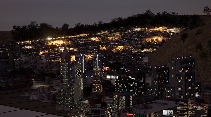

In this night scene below, there are several hundreds of light sources:
D5 Fluidité|Capacité de grandes scènes et interactivité en temps réel
In the old version, the memory cannot be dynamically allocated according to the number of lights when calculating shading, so it must be allocated in advance according to the maximum number of lights (e.g. 1024 lights). Higher screen resolution means higher memory overhead, which poses a challenge to the performance of the real-time preview.
To solve this problem, D5 optimized the strategy of sampling lights. First, D5 divides 1024 lights into groups, calculating the total brightness of lights in each group, and then further sampling the specific lights in the groups that contribute more to the scene. With this optimization, the time of calculating GI for a scene with 1024 lights drops from 23.84 ms to 11.54 ms, and memory usage is reduced by about 150MB.

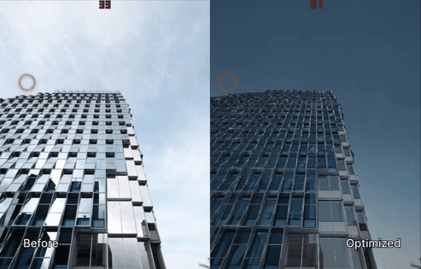

The example below shows a comparison of the “smoothness” of D5 version 1.9 and D5 version 2.1:
Note: You can see that the new version of D5 on the right responds to commands (click to move camera views) significantly faster than the old version (it always moves faster than the left one). And, the frame rate of the new version is nearly doubled when shaking the viewport.
