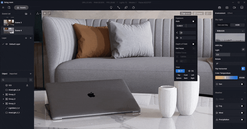

You can turn on Depth of Field in the Camera option in the upper right corner of the viewport. Select 포커스 설정 and click on the object which you want to focus on.
To make the background blurrier, you can increase the Blur intensity.
Please note that you can set only one focus for a scene.

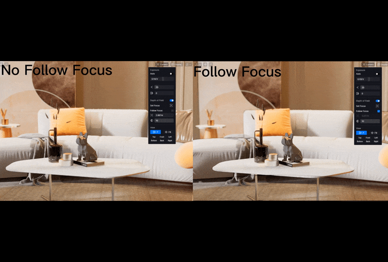

When Follow Focus is turned on, the camera will always focus on the object you choose. This feature is of great help when you don’t want to lose the camera focus for the animation.
D5에서 시네마틱 애니메이션을 위한 심도의 활용법

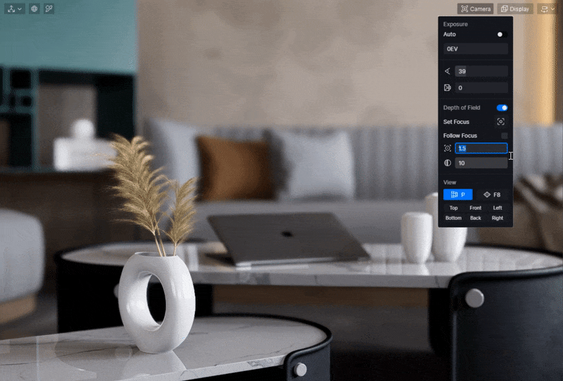

If Follow Focus is turned off, you need to adjust the Focus Distance manually. Please note that this parameter is not the focal distance in photography but a value to determine the distance between the camera and the vertical focus plane. It is usually used when you need to accurately tweak the focus position on an object.

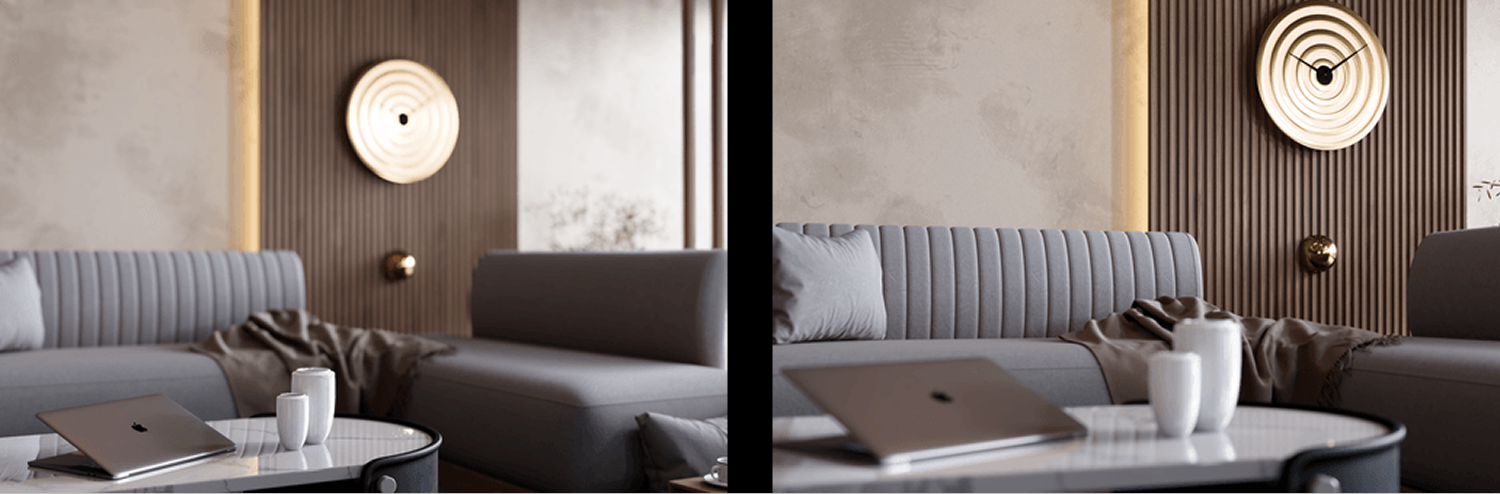

D5 Render makes it quite easy to create the photographic effects of Focus shift and DoF change commonly used in films.
Animation making in D5 Render

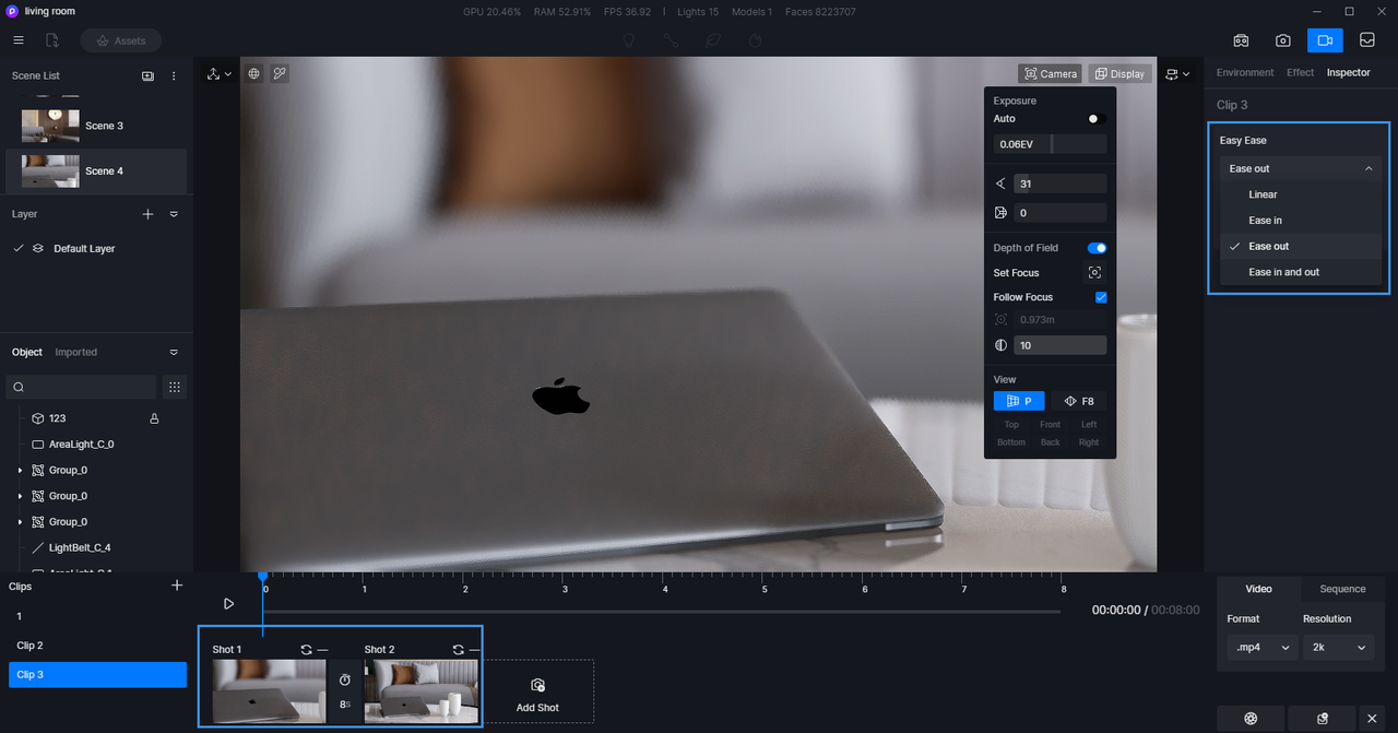

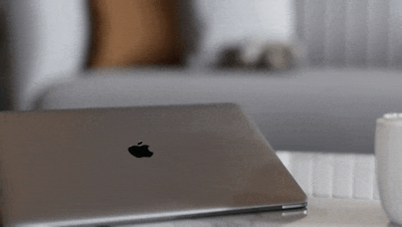

First add two or more shots to the timeline and set multiple keyframes with different DoF settings, including focus position and blur intensity (it is not recommended to turn on/off DoF directly in keyframes). Then you can add Easy Ease to work with DoF, making its change smoother.

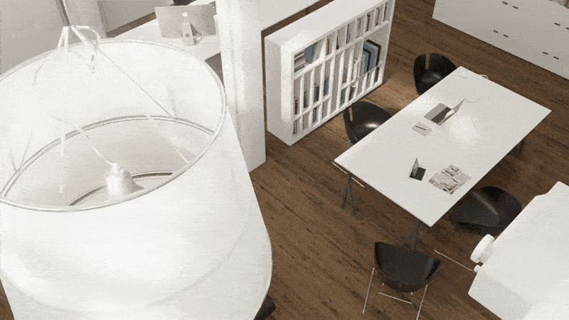

Done! That’s all you need to do to create a gorgeous animation like this:
