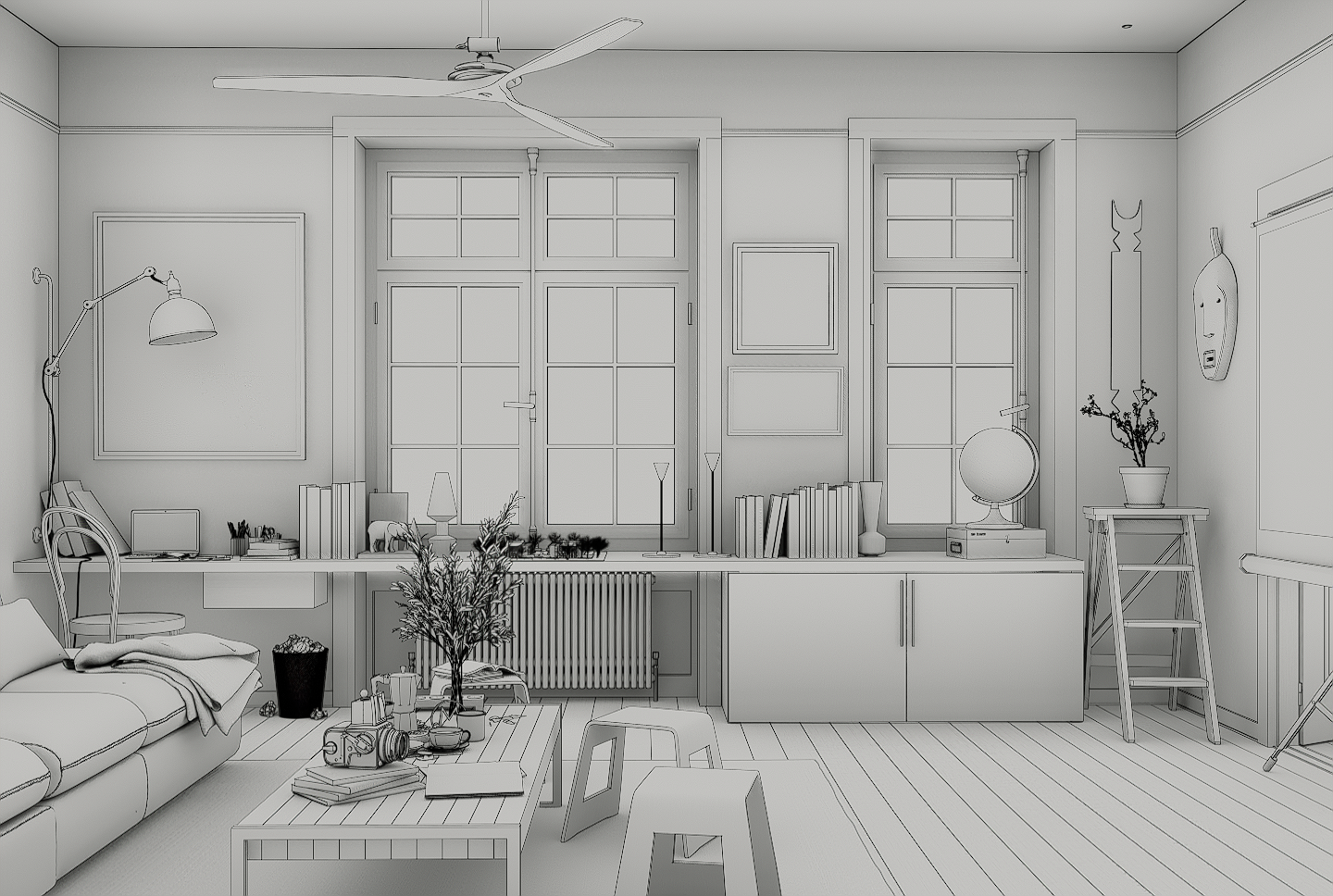

The AO-style rendering created with D5 Render

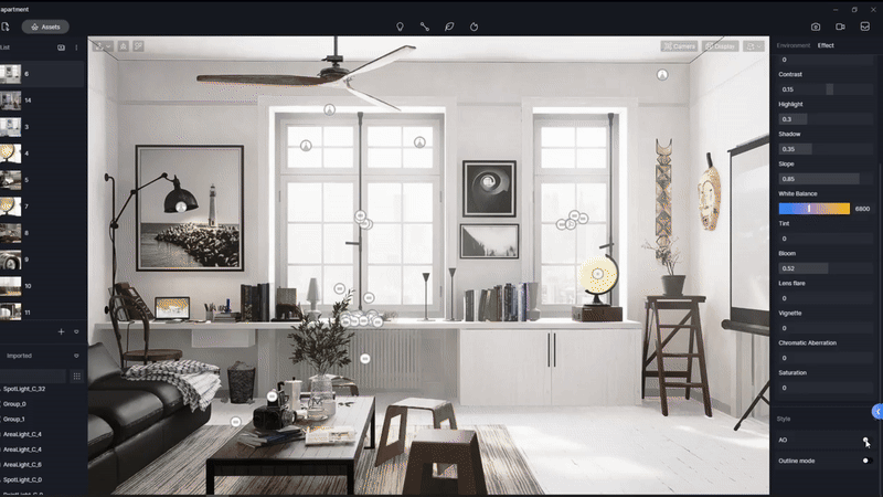

You can switch on “AO” in the effect panel and adjust its Radius to control the extent to which a location on the surface is obscured from surrounding light sources.

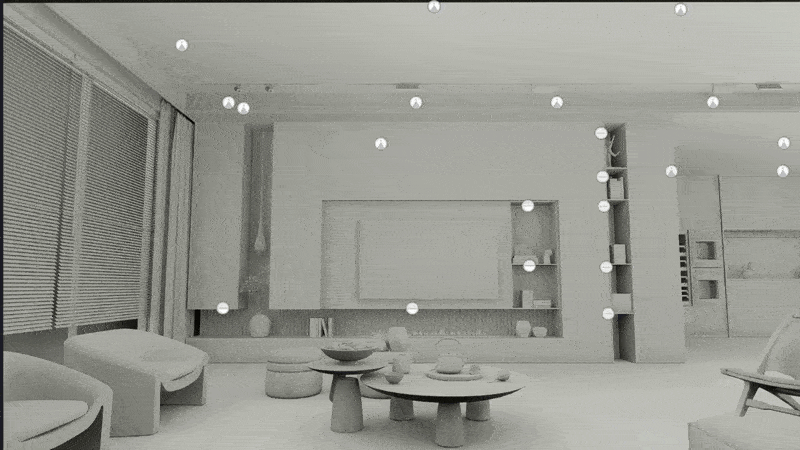

You can also output images with the AO map to check the light and shadow info.

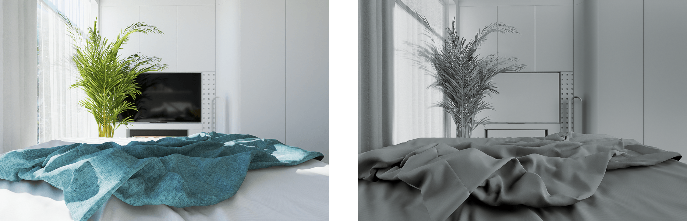

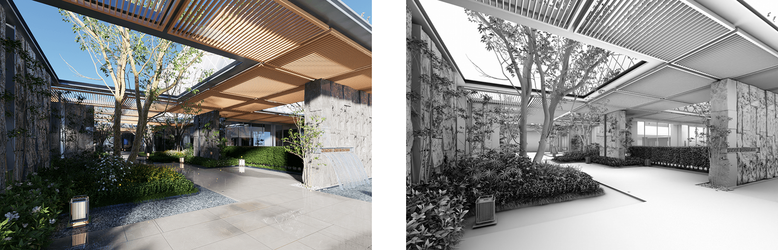

AO maps help enhance the shadows in a scene. Visualizers usually use the AO map in Photoshop to produce a more realistic light-and-shadow contrast.
To output an AO map in D5 Render, go to Image Render > Channels and check “AO”.

To create a rendering like this, you should go to the “Effect” panel, scroll down and find the “Style” section where the switches of AO and Outline modes are located.
The larger the Radius of AO, the wider the dark area will be.
