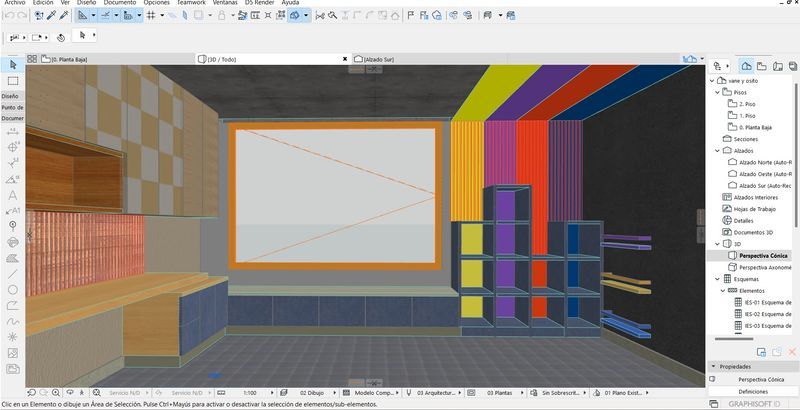

Modeling with Archicad:
The modeling process is inspiring and creative as I managed to bring the client’s imagination to reality. In those hours, I can wrap myself up in my creation.
User Showcase: Archicad Interior Visualization with D5
My favorite part of this project design is the colorful stripes on the wall and roof.
After creating the stripe slabs with a proper size, I gave them four different colors, which made it easier to tell them apart when adjusting materials in D5 Render later.

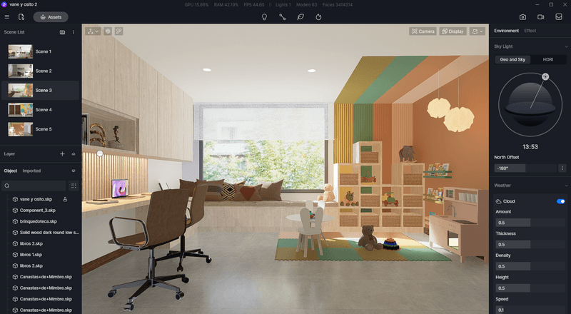

To import the model directly to D5 Render, I highly recommend the direct link plugin — D5 Converter for Archicad. It builds a seamless and integrated workflow between modeling and rendering, as models, materials and later changes to them can all be quickly imported from Archicad to D5. I can also make the most of D5’s real-time-rendering feature to check around the visualized project.
Click hereto learn more about D5 Converter – Archicad.

The same as what I had done to the stripes, in Archicad I gave all the model surfaces different colors for easier texture editing in D5.

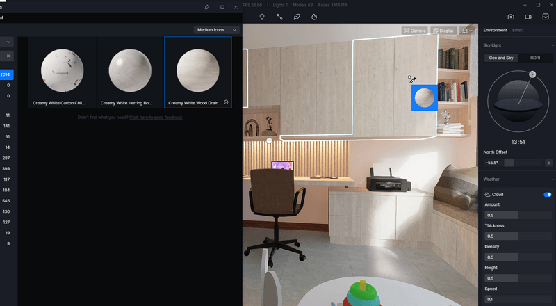

In order to highlight the colorful strips on the right side of the room, I decided to paint other pieces of furniture with a beige tone. Thus the “Creamy White Wood Grain” material from D5 Render’s built-in Asset Library becomes an optimal choice. It’s a ready-made texture, so no subsequent adjustments are required.
The material could be copied with the shortcut key “I” and pasted to another surface like the desk and shelf with the shortcut key “O”.
For the two hanging ceiling lamps, I turned on “Emissive” to make them a self-glowing material. The “Cast Shadow” option was switched off so they didn’t have shadows on the wall next by.

In this project I only used D5 Render’s “Geo and Sky” system to simulate the natural afternoon sunlight and a strip light as supplementary to illuminate the desk. Yet the lighting was quite realistic and satisfactory.
To balance the lighting effect, I also added some emissive ceiling lights as I had said before. These were simple tricks, but they worked quite well in D5 Render.
