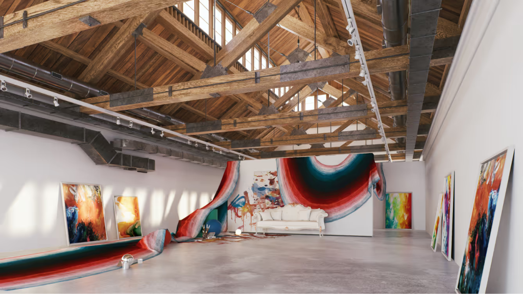

Designers often strive to create renderings so realistic that they are indistinguishable from photographs. Detailed modeling plays a significant role in achieving realism, but advanced rendering software capable of accurately simulating light and materials in the real world is essential to take renderings to the next level.
Global Illumination (GI) is the technique in computer graphics that replicates realistic lighting interactions. It calculates not only the direct lighting from a source but also the indirect lighting that reaches a surface after multiple bounces.
In the real world, light continues to bounce off surfaces until its energy dissipates. Simulating this phenomenon is crucial for producing renderings with realistic brightness, contrast, and detail.
GI aims to solve the problem of light bouncing in the scene twice and afterwards, which can bring better brightness and detail to the parts that are not illuminated by direct lighting. It plays a crucial role in creating photorealistic renderings that can trick the human eye.

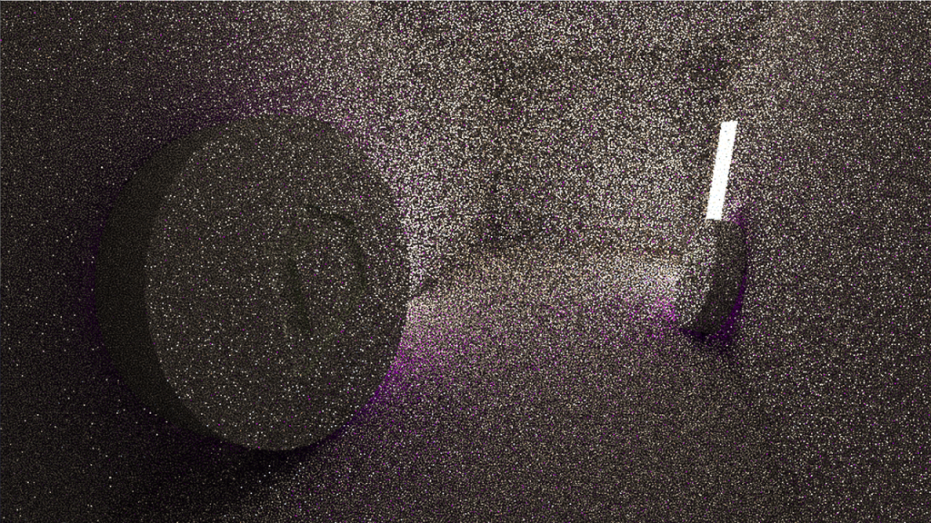

D5 uses ReSTIR on GI to store the paths of rays rather than sampling light sources. ReSTIR GI reduces the variance of the sampling results by reusing sample information between frames and between neighboring pixels, allowing it to achieve high-quality results even when there’re only a small number of samples.
D5 Render applies ReSTIR to GI by:- Storing ray paths rather than sampling light sources directly.- Minimizing temporal lag with Path Validation, which adjusts reused samples when brightness or object positions change dynamically.

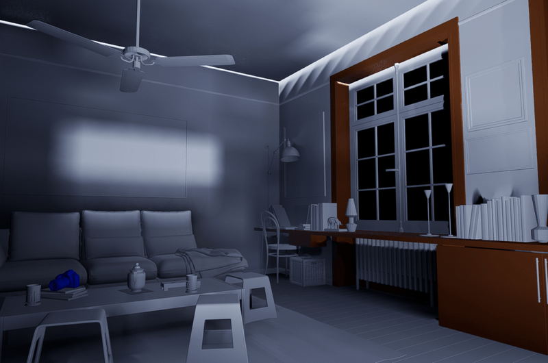

The D5 GI solution has been significantly enhanced to incorporate skylight into both primary and secondary GI bounces, resulting in realistic lighting even in spaces with substantial depth.
This improvement ensures brighter interiors with smooth transitions between light and shadow. GI calculations now use local texture colors directly, providing more accurate color transitions and enhancing the realism of indirect lighting and reflections. These updates eliminate the overly brightened look of previous versions while achieving realistic color differentiation. Users seeking controlled saturation can enable the “Limit Color Bleeding” option.

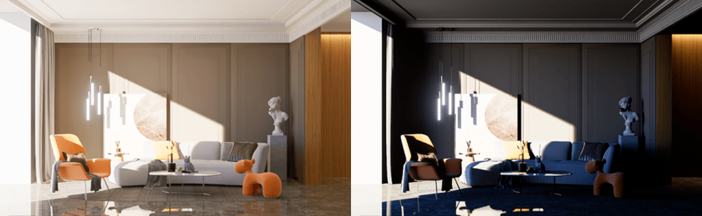

In the older version, interior lighting appeared warmer and metals darker.
The updated version has neutral color temperature and brighter metals.

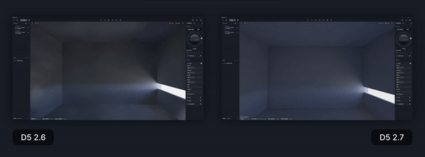

The newest version features higher GI sampling accuracy, delivering better contrast in backlit areas, clearer bounce lighting, and more defined occlusion shadows in crevices. These refinements bring lighting effects closer to real-life expectations, improving both subtle and high-contrast scenarios.

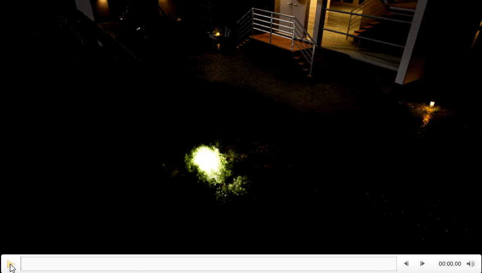

Thanks to Light Grid technology, direct lighting is now more stable in scenes with multiple light sources, intense brightness, and complex occlusions, reducing flickering and ensuring smoother video rendering, particularly for plants in night scenes.
In the older version, videos having plants illuminated by a very bright light source had flickers.
In the D5 latest version, stable video rendering of plants in the same night scene.
