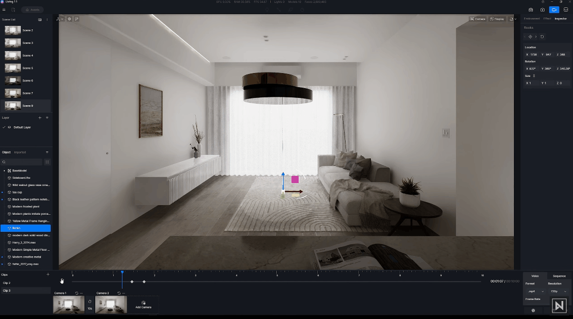

Utilize Keyframe for phasing animation

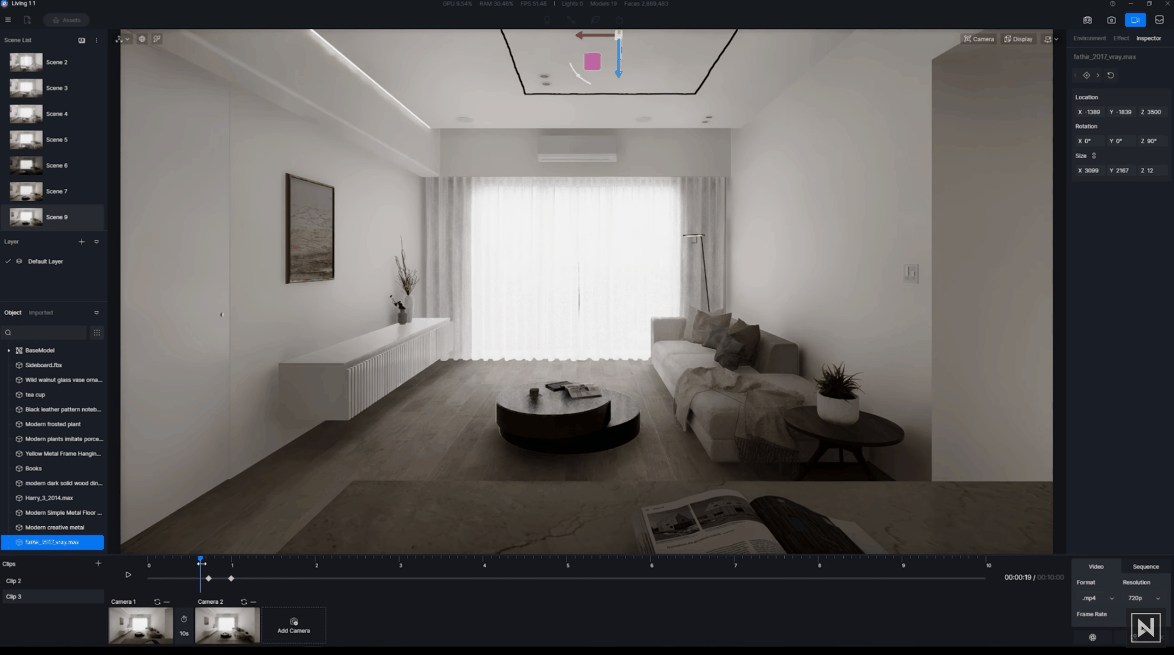

A keyframe is a specific point in time used in animation and video production to mark the start or end of an animated movement or change, allowing animators to create smooth and complex animations.
Take this carpet as an example.

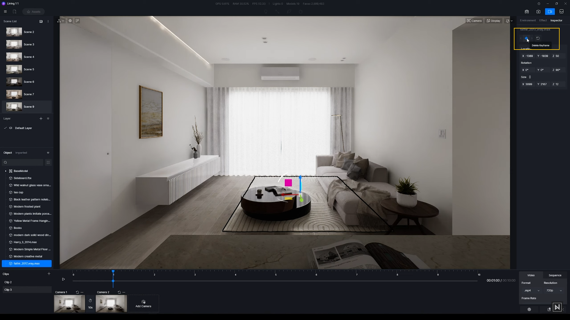

End keyframe: If we want the carpet to drop down from the ceiling, first add a keyframe when it’s still on the ground. This refers to its end position.
How To Make an Interior Phasing Animation

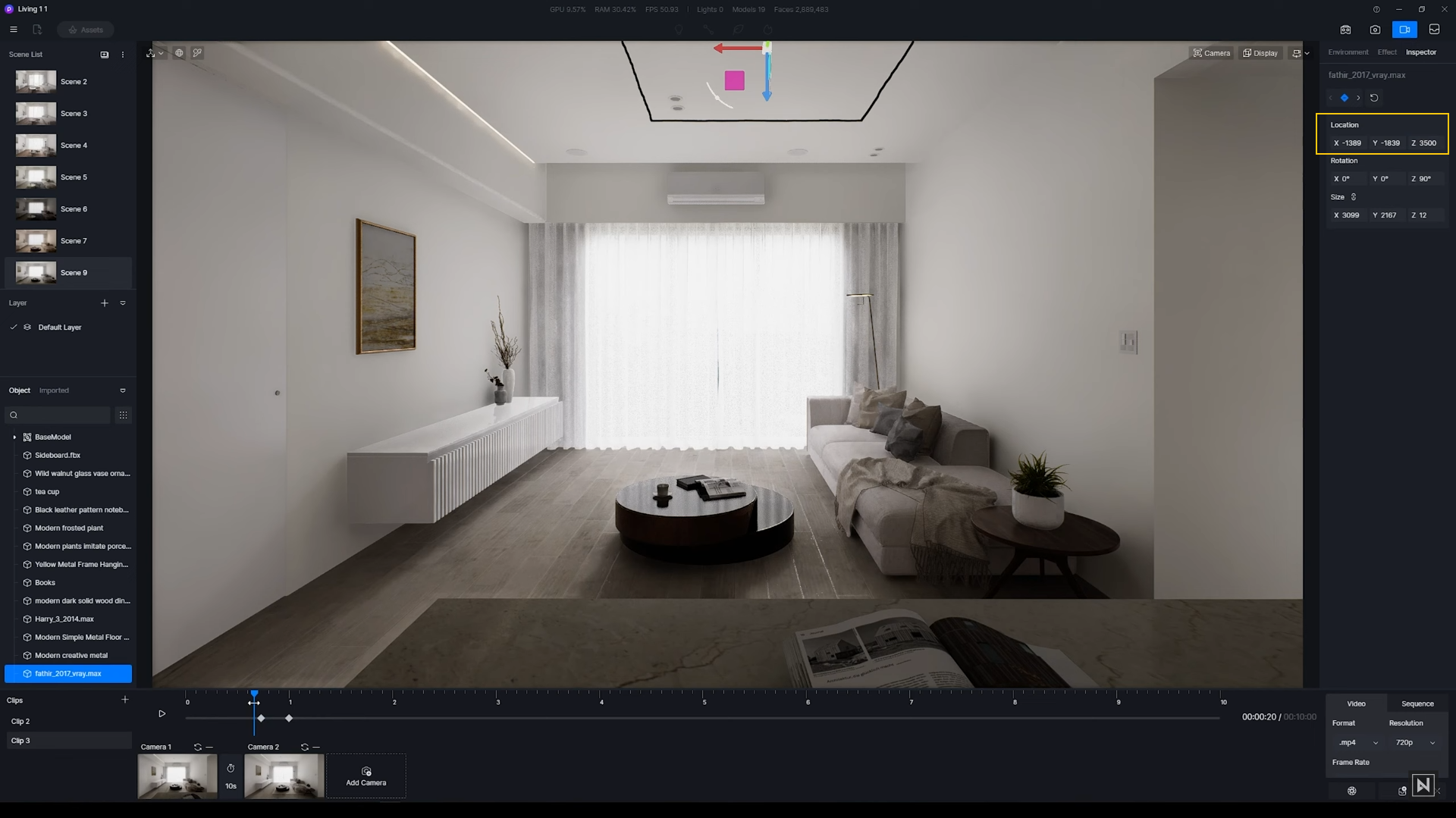

Start keyframe: Then, move it up by changing the z coordinate. Add another keyframe before the end one on the timeline, representing the start position of the carpet.

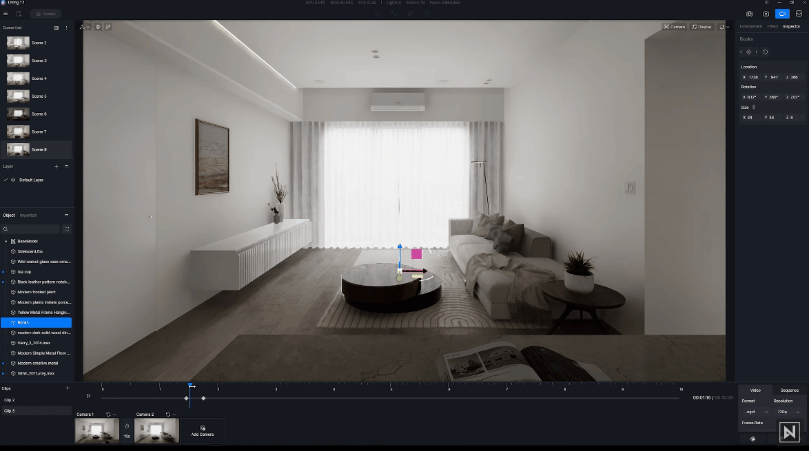

Here’s the preview:

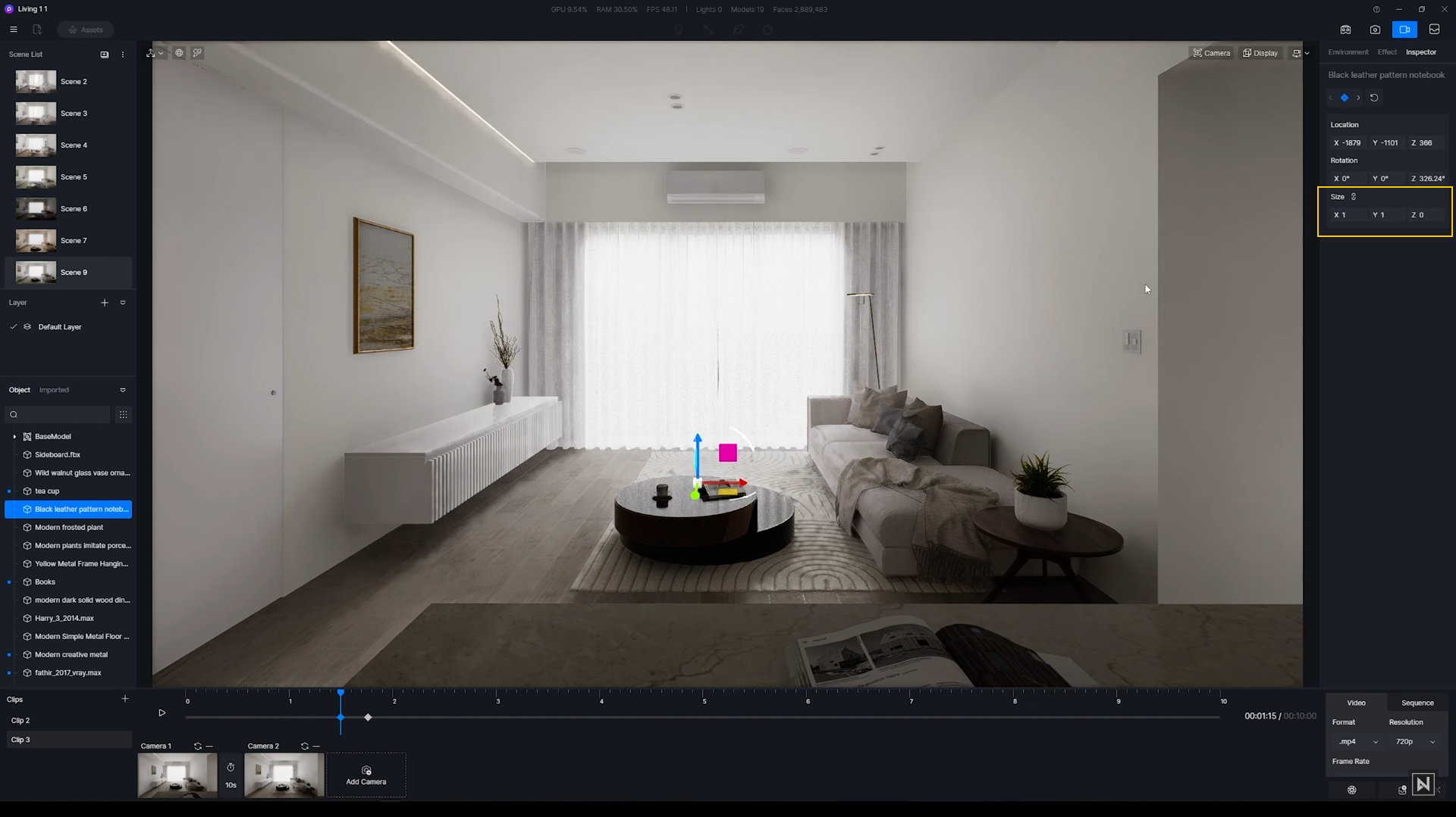

  • How to make an object “growing” in size:
After adding the end keyframe, set the size of the target to 1,1,0 and add the start keyframe.
Here’s the preview:

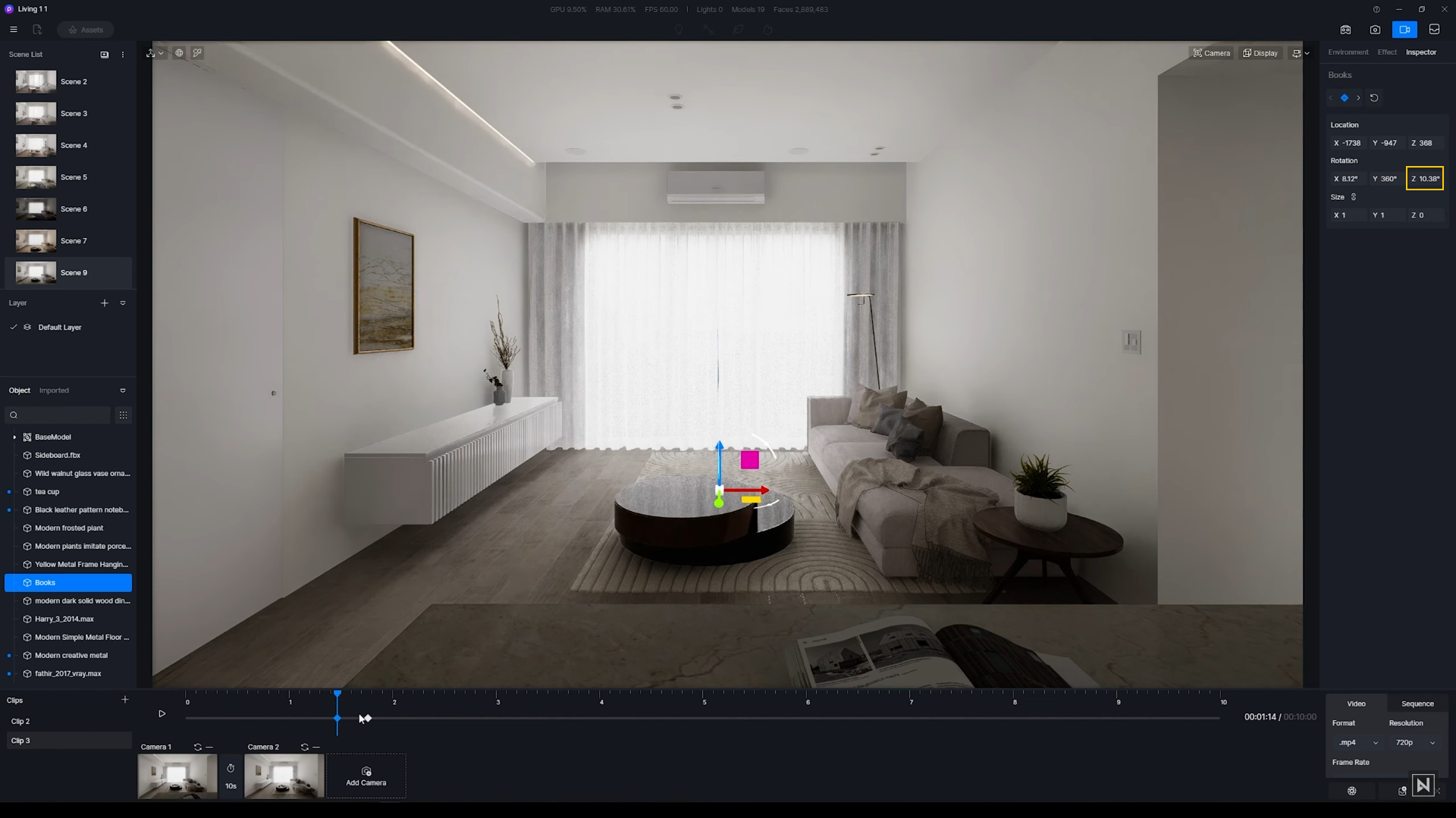

  • How to create an object rotating to make a presence:
You only need to rotate the book a bit at the start keyframe.
Here’s the preview:
