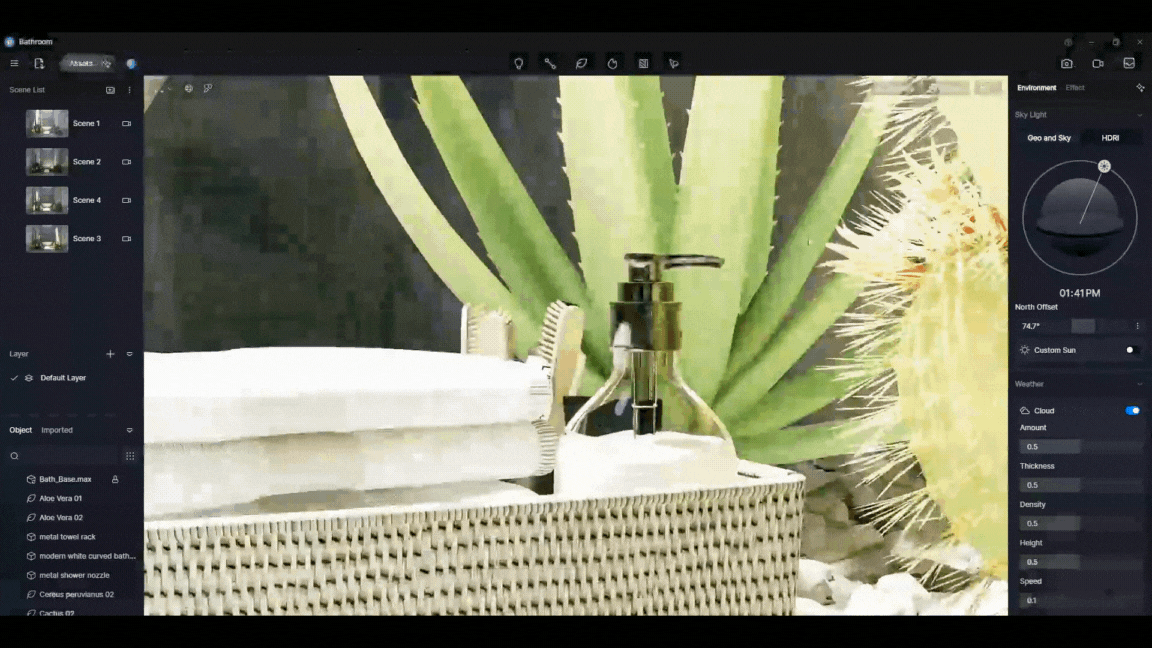

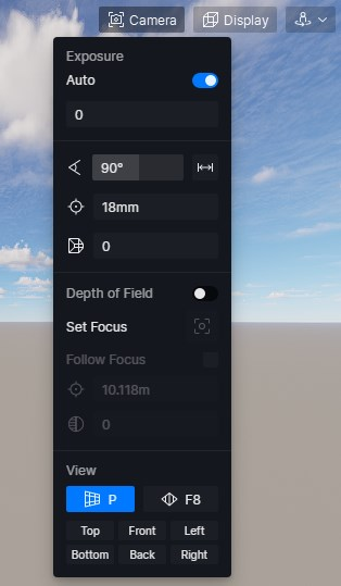

Camera and Views
  • Depth of Field (DOF): Blur foregrounds or backgrounds to emphasize subjects and add realism.
D5 Depth of field setting
Depth of Field

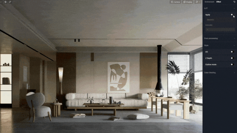

  • Saturation & Contrast: Increase vibrancy or create muted, cinematic moods.
  • LUTs (Look-Up Tables): Apply color grading presets to set the emotional tone of your render.
Look up tables d5 render
Tip: Place a white sphere in the scene and adjust the white balance until it appears neutral to eliminate color casts.
Use visual storytelling techniques seen in films—cool tones for futuristic moods (Blade Runner), warm tones for intimacy (Her), or desaturation for stark environments (Mad Max). D5’s post-processing tools let you emulate these cinematic effects seamlessly.

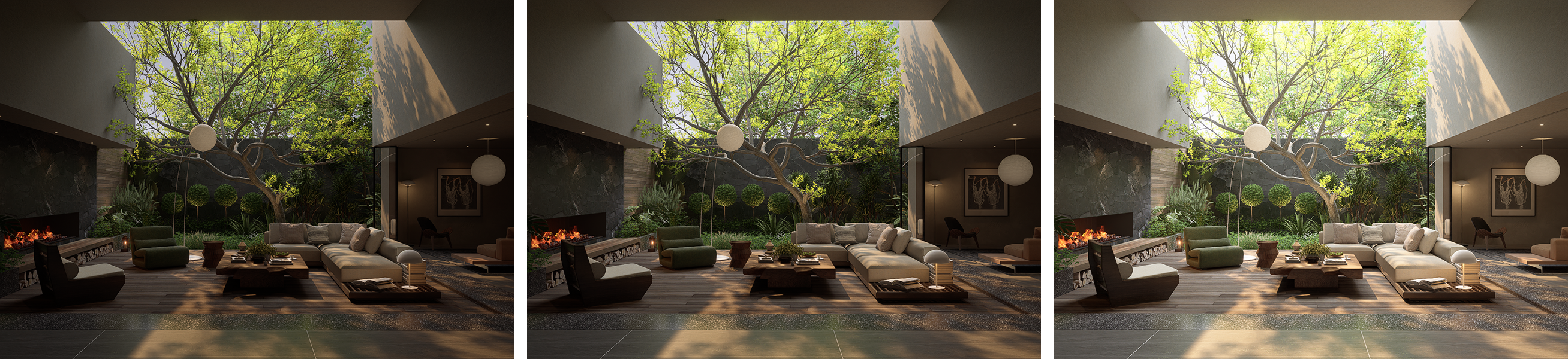

Exposure: Mastering Light and Shadow
Exposure determines your image’s brightness and how well it captures lighting details. In rendering, it plays a central role in realism and clarity
exposure on d5 render
Lower to higher exposure
Exposure Tools in D5 Render:
  • Manual Exposure (EV Slider): Adjust overall brightness to suit your lighting conditions.
  • Highlight/Shadow Adjustments: Recover details in extreme lighting.
  • Tone Mapping: Balance dynamic range for natural light transitions.
  • Bloom & Lens Flare: Add glow and camera-like effects to enhance atmosphere.

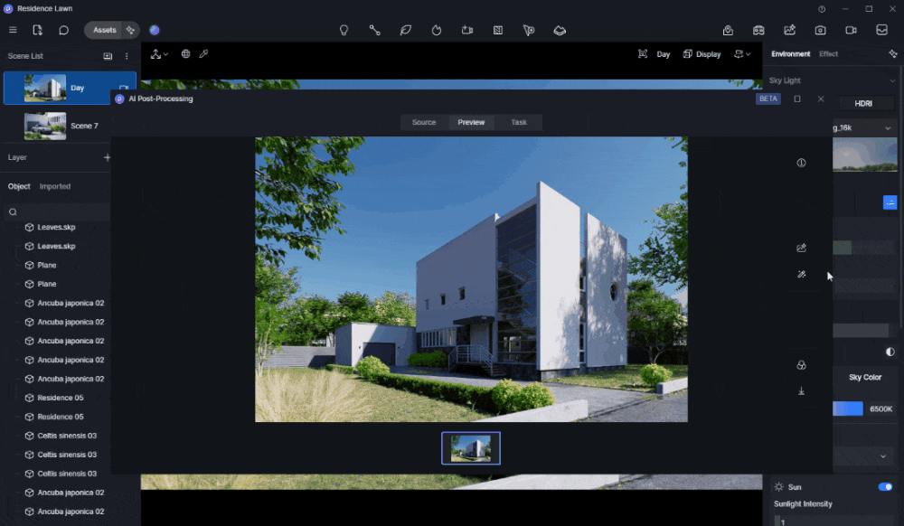

AI Enhancer: Automating Realism Without Losing Control
D5 Render’s AI Enhancer refines lighting and materials using intelligent automation. It’s a productivity tool and a creative ally, especially for enhancing final renders.
Features:
  • Selective Enhancement: Target specific areas without affecting the whole image.
Photography Techniques for Photorealistic Rendering: Framing, Color Balance & Exposure
  • Intensity Levels: Choose weak, normal, or strong adjustments for lighting and materials.
  • Material Refinement: Improves reflections, textures, and surface realism.
  • Lighting Correction: Automatically balances inconsistent lighting.
Tip: Use AI Enhancer to sharpen wood textures, add highlight to fabric, or even out lighting in dim corners—without manual rework.

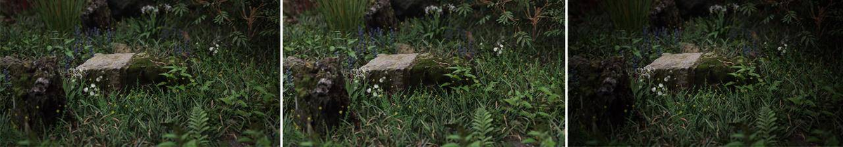

  • Vignette: Darkens image edges to direct focus to the center.
vignette render
Post Vignette 0.5 | Normal | Post Vignette 1.0

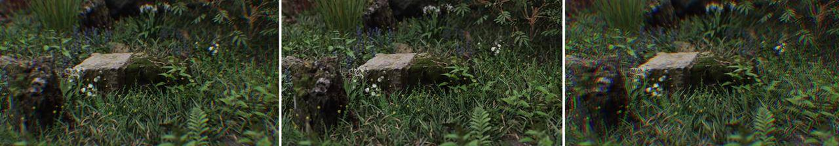

  • Chromatic Aberration: Simulates camera lens imperfections for realism.
Post Chromatic Aberration 2.5 | Normal | Post Chromatic Aberration 5.0
